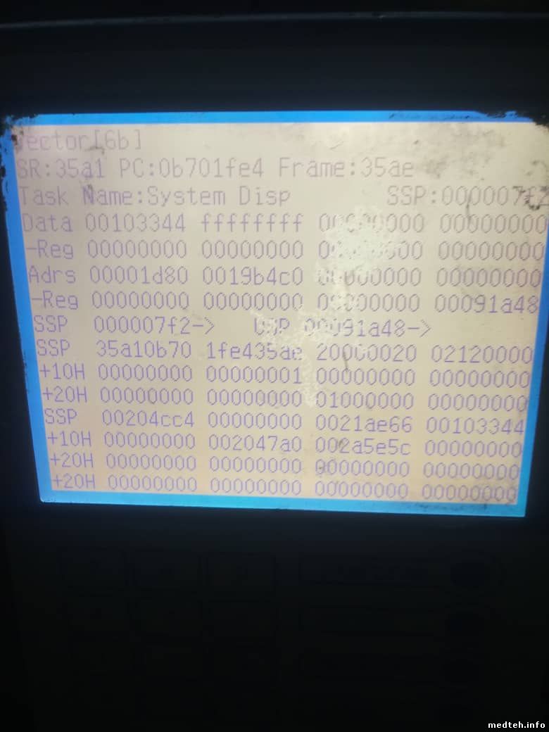

AdvancemedДата: Вторник, 05.Ноя.2019, 03:01 | Сообщение # 52
Laboratory analyzer
Йемен
Sana`a
Hello Everyone
Who is faced like this problem before?
waiting for ur help
thank you an advance

AdvancemedДата: Четверг, 19.Дек.2019, 03:53 | Сообщение # 56
Laboratory analyzer
Йемен
Sana`a
Hello
The problem solved,
I executed the following procedures:
1) Connect the battery connector on PCB No. 6370.
2) Change the Bit 1 of DIP Switch S1 to “ON” to initialize the memory.
3) Turn the instrument power ON.
4) When the initialization is completed, the message "Entire memory area was initialized.
Turn OFF the power." will be displayed. Turn the instrument power OFF.
5) Change the Bit 1 of DIP Switch S1 to “OFF”.
6) Turn the instrument power ON to start up the instrument.
6) Change language from Japan to English and Turn the instrument power OFF and turn on again.
