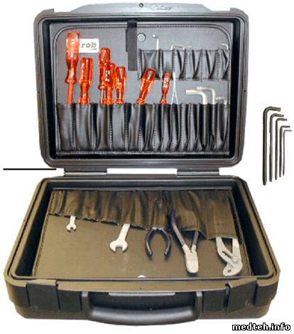

Уважаемые форумчане, подскажите пожалуйста примерный перечень немагнитного инструмента необходимого для обслужива МРТ Siemens Magnetom Symphony 1,5Тл и где его лучше заказать?

Non-magnetic steel tool set
complete
Non-magnetic fork wrench 6/7mm
Non-magnetic fork wrench 8/9 mm
Non-magnetic fork wrench 10/11 mm
Non-magnetic fork wrench 12/13 mm
Non-magnetic fork wrench 14/15 mm
Non-magnetic fork wrench 16/17 mm
Non-magnetic fork wrench 18/19 mm
Non-magnetic fork wrench 20/22 mm
Non-magnetic fork wrench 21/23mm
Non-magnetic fork wrench 24/26mm
Double open ended wrench 27X32
Double open ended wrench 30X36
Cranked wrench key (imbus) 2.5mm
Allen key 3mm with ball head no
Allen key 4mm with ball head no
Allen key 5mm with ball head no
Allen key 6mm with ball head no
Allen key 8mm with ball head no
Non-magnetic Allen key 2mm
Non-magnetic Allen key 3mm
Non-magnetic Allen key 4mm
Non-magnetic Allen key 5mm
Non-magnetic Allen key 6mm
Non-magnetic Allen key 8mm
Non-magnetic Allen key 10mm
' on-magnet'c or wrenc lU/ll
Non-magnetic Allen key 1/16
Non-magnetic Allen key 3/32
Screwdriver 0.6x4 short, nonmag.
Screwdriver 1x6.5 short, nonmag.
Screwdriver 1.2x8 nonmag
Non-magnetic screwdriver 0.6x2
Non-magnetic screwdriver 0.8x3
Non-magnetic screwdriver 1.0x4
Non-magnetic screwdriver 1.6
Non-mag. Phillips screwdriver 3mm
Non-mag. Phillips screwdr. 4.5mm
Non-mag. Phillips screwdr. 6mm
Non-magnetic steel tweezers 110mm
Non-magnetic steel diagonal cutter
Non-magnetic steel flat round plier
Non-magnetic steel water pump plier
Torx key, TX9 nonmagnetic
Torx key, TX10 nonmagnetic
Torx key, TX15 nonmagnetic
Torx key, TX20 nonmagnetic
Torx key, TX25 nonmagnetic
Torx key, TX27 nonmagnetic
Torx key, TX30 non-mag
Torx key, TX40 non-mag
