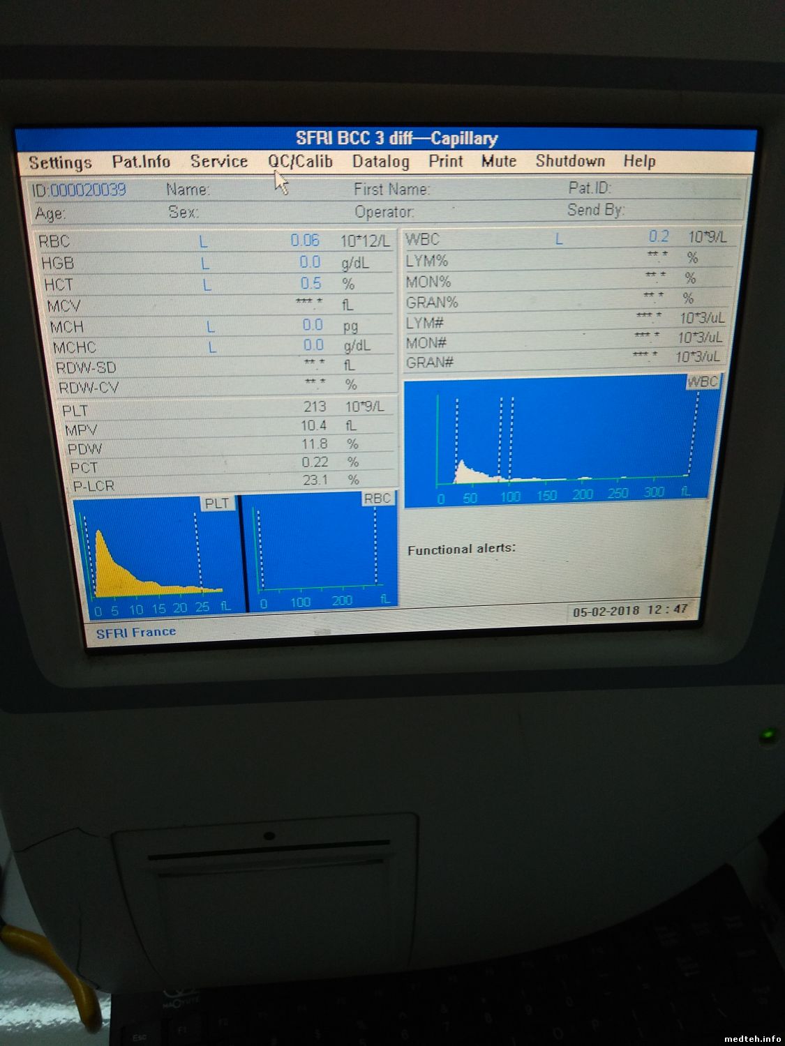

Кто поможет мне PLT SFRI?
Очищены и заменены счетчики RBC
Замененный раствор разбавителя и промывка
Теперь я не знаю, что делать?
AlexiumДата: Понедельник, 05.Фев.2018, 19:35 | Сообщение # 6
heatpump84, - bad electrical ground, bad power supply, chamber crack and micro bubbles in aperture.
heatpump84Дата: Понедельник, 05.Фев.2018, 21:06 | Сообщение # 7
ádfafa
Вьетнам
nhatrang
This SFRI had connected well with ground.
I had replace new chamber.
Replace new diluent and no bubbles in aperture.
Get an new sample RBC is the same result with XP100.
This machine just have an trouble with PLT.
I can't understand.

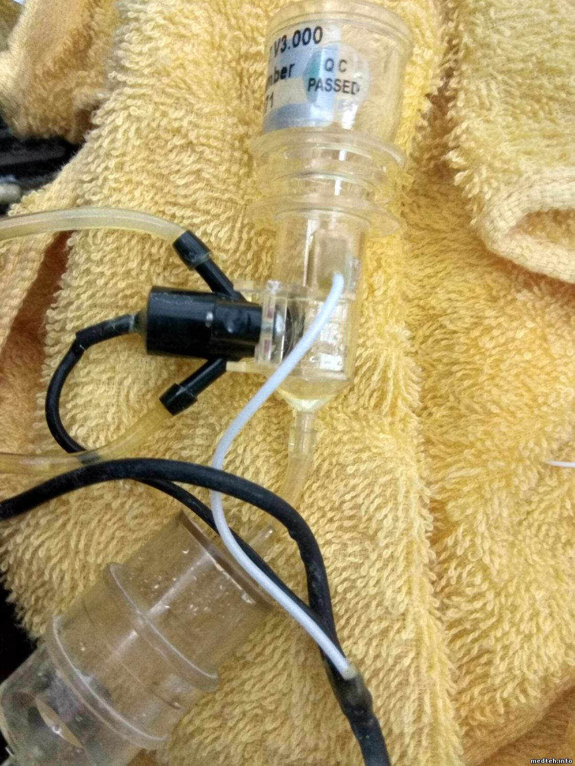

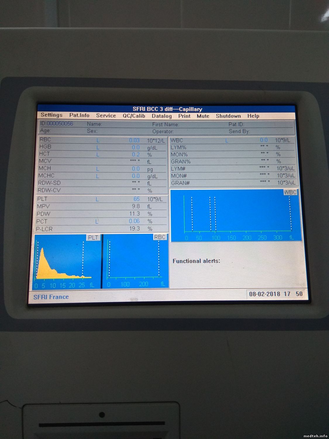

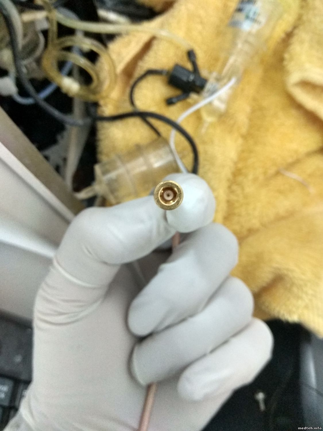

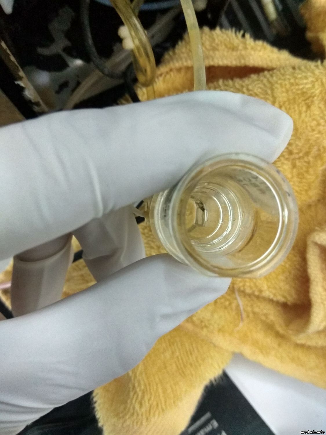

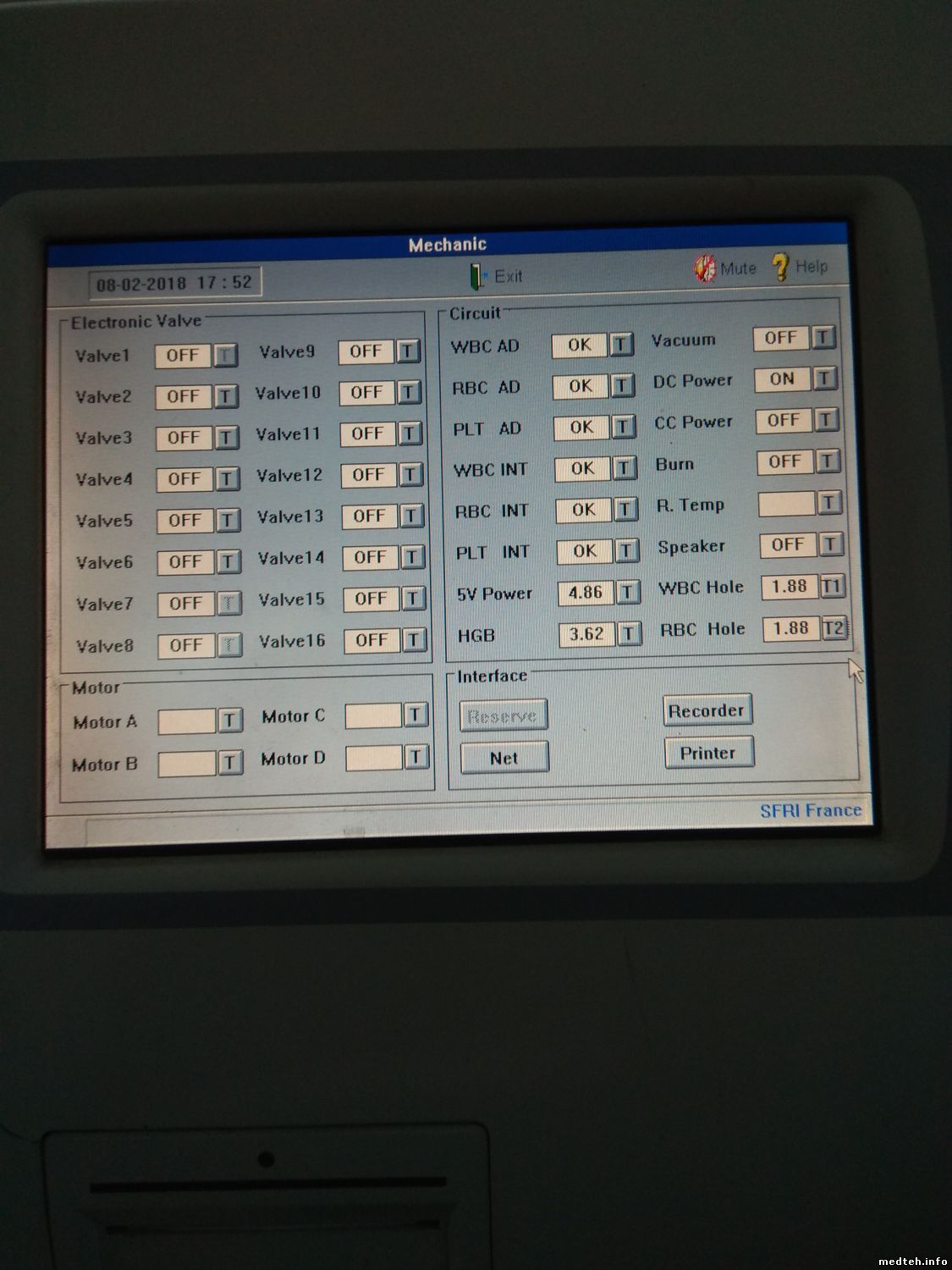

heatpump84Дата: Пятница, 09.Фев.2018, 21:40 | Сообщение # 14
ádfafa
Вьетнам
nhatrang
Dear Tzaneff,
I had tried disconect RBC chamber and run a sample everything -0 that i can sure CCU board ok.
But when reconect RBC and run sample all result very bad.I had used a scalpel clear surface of electrode and run sample, the fist result very good all thing are zero, the second result PLT -65 and the thrid PLT-151.
I guess new RBC chamber have problem.

AlexiumДата: Пятница, 09.Фев.2018, 23:25 | Сообщение # 15
Dear friend, make some photos of the internal analyzer. Chamber like a Mindray!
