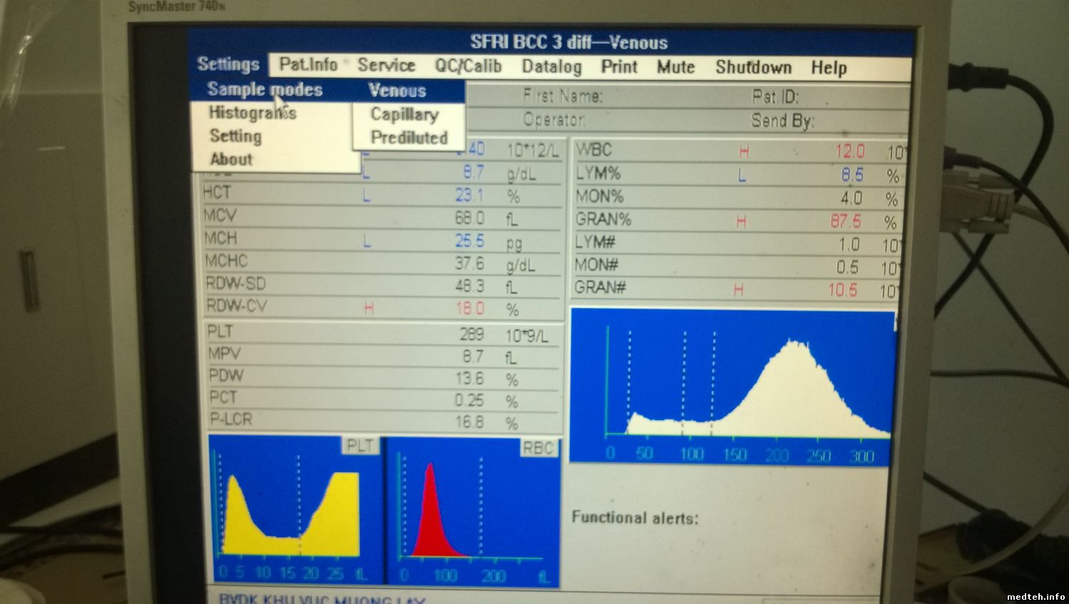

problem platelet histogram

AlexiumДата: Пятница, 18.Июл.2014, 12:21 | Сообщение # 4
??? - what problem?
I see low HGB, low RBC and normal PLT.

in picture (1) what problem ? not right normal PLT histogram
and results are not stable at high, low

AlexiumДата: Пятница, 18.Июл.2014, 17:55 | Сообщение # 6
in circle 1 - RBC, not PLT.

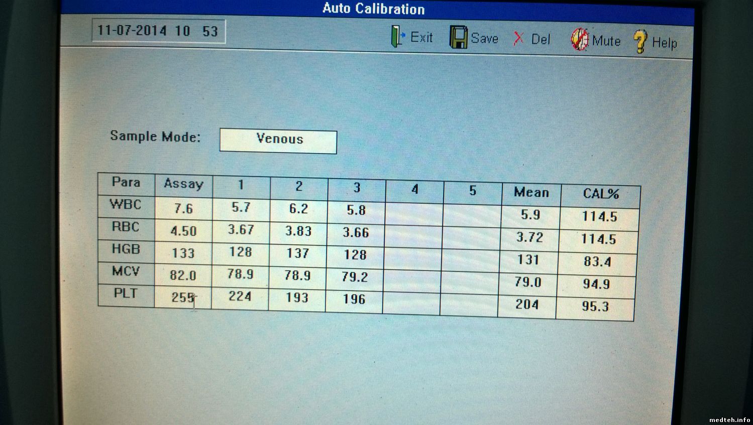

Make a blood control (Normal). What result?
RBC chamber crack? Less or low Lyser? (Menu)Service-mechanic-RBC hole - what result???

Resultt Blood Control .

AlexiumДата: Суббота, 19.Июл.2014, 14:52 | Сообщение # 8
Maintenance vacuum pump, diluter block.
RBC hole and WBC hole - what value?
In RBC and WBC chamber - cracked?
