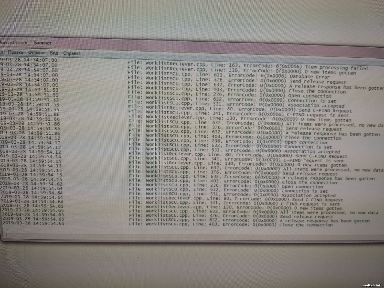

Логи самого аппараты выглядят следующим образом:
2019-03-12 14:42:55.83 File: WorklistSCU.cpp, Line: 236, ErrorCode: 0(0x0000) Open connection
2019-03-12 14:42:55.83 File: WorklistSCU.cpp, Line: 632, ErrorCode: 0(0x0000) Connection is set
2019-03-12 14:42:55.85 File: WorklistSCU.cpp, Line: 531, ErrorCode: 0(0x0000) Association accepted
2019-03-12 14:42:55.85 File: WorklistReciever.cpp, Line: 80, ErrorCode: 0(0x0000) Send C-FIND Request
2019-03-12 14:42:55.85 File: WorklistSCU.cpp, Line: 341, ErrorCode: 0(0x0000) C-FIND request is sent
2019-03-12 14:42:55.86 File: WorklistReciever.cpp, Line: 130, ErrorCode: 0(0x0000) 0 new items gotten
2019-03-12 14:42:55.86 File: WorklistSCU.cpp, Line: 632, ErrorCode: 0(0x0000) All items were processed, no new data
2019-03-12 14:42:55.86 File: WorklistSCU.cpp, Line: 376, ErrorCode: 0(0x0000) Send release request
2019-03-12 14:42:55.86 File: WorklistSCU.cpp, Line: 632, ErrorCode: 0(0x0000) A release response has been gotten
2019-03-12 14:42:55.86 File: WorklistSCU.cpp, Line: 403, ErrorCode: 0(0x0000) Close the connection
2019-03-12 14:43:02.80 File: WorklistSCU.cpp, Line: 236, ErrorCode: 0(0x0000) Open connection
2019-03-12 14:43:02.82 File: WorklistSCU.cpp, Line: 632, ErrorCode: 0(0x0000) Connection is set
2019-03-12 14:43:02.82 File: WorklistSCU.cpp, Line: 531, ErrorCode: 0(0x0000) Association accepted
2019-03-12 14:43:02.82 File: WorklistReciever.cpp, Line: 80, ErrorCode: 0(0x0000) Send C-FIND Request
2019-03-12 14:43:02.82 File: WorklistSCU.cpp, Line: 341, ErrorCode: 0(0x0000) C-FIND request is sent
2019-03-12 14:43:02.84 File: WorklistReciever.cpp, Line: 163, ErrorCode: 6(0x0006) Item processing failed
2019-03-12 14:43:02.84 File: WorklistReciever.cpp, Line: 130, ErrorCode: 0(0x0000) 0 new items gotten
2019-03-12 14:43:02.84 File: WorklistSCU.cpp, Line: 611, ErrorCode: 6(0x0006) Database Error
2019-03-12 14:43:02.84 File: WorklistSCU.cpp, Line: 376, ErrorCode: 0(0x0000) Send release request
2019-03-12 14:43:02.84 File: WorklistSCU.cpp, Line: 632, ErrorCode: 0(0x0000) A release response has been gotten
2019-03-12 14:43:02.84 File: WorklistSCU.cpp, Line: 403, ErrorCode: 0(0x0000) Close the connection

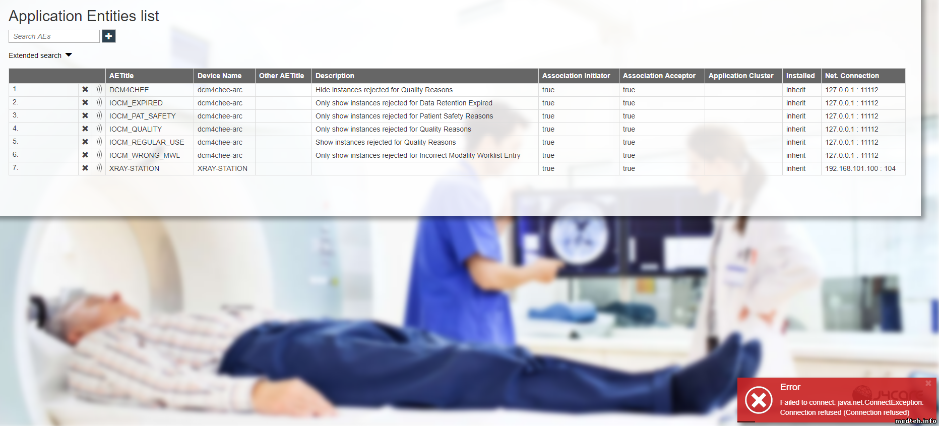

2019-03-12 14:42:58,448 INFO [org.dcm4chee.arc.procedure.scp.MWLCFindSCP] (EE-ManagedExecutorService-default-Thread-65) DCM4CHEE<-QWERTY(46): Process MWL C-FIND RQ:
(FFFA,FFFA) SQ [1 Items] DigitalSignaturesSequence
>Item #1
>(0400,0005) US [] MACIDNumber
>(0400,0100) UI [] DigitalSignatureUID
>(0400,0105) DT [] DigitalSignatureDateTime
>(0400,0110) CS [] CertificateType
>(0400,0115) OB [] CertificateOfSigner
>(0400,0120) OB [] Signature
>(0400,0305) CS [] CertifiedTimestampType
>(0400,0310) OB [] CertifiedTimestamp
(0008,0005) CS [] SpecificCharacterSet
(0008,0012) DA [] InstanceCreationDate
(0008,0013) TM [] InstanceCreationTime
(0008,0014) UI [] InstanceCreatorUID
(0008,0016) UI [1.2.840.10008.5.1.4.31] SOPClassUID
(0008,0018) UI [] SOPInstanceUID
(0008,0050) SH [] AccessionNumber
(0008,0080) LO [] InstitutionName
(0008,0081) ST [] InstitutionAddress
(0008,0082) SQ [1 Items] InstitutionCodeSequence
>Item #1
>(0008,0100) SH [] CodeValue
>(0008,0102) SH [] CodingSchemeDesignator
>(0008,0103) SH [] CodingSchemeVersion
>(0008,0104) LO [] CodeMeaning
>(0008,0105) CS [] MappingResource
>(0008,0106) DT [] ContextGroupVersion
>(0008,0107) DT [] ContextGroupLocalVersion
>(0008,010B) CS [] ContextGroupExtensionFlag
>(0008,010D) UI [] ContextGroupExtensionCreatorUID
>(0008,010F) CS [] ContextIdentifier
(0008,0090) PN [] ReferringPhysicianName
(0008,0092) ST [] ReferringPhysicianAddress
(0008,0094) SH [] ReferringPhysicianTelephoneNumbers
(0008,0096) SQ [1 Items] ReferringPhysicianIdentificationSequence
>Item #1
>>Item #1
Правильно ли я понимаю, что это и есть условия фильтра?
Не понятно лишь, как все же должен выглядеть worklist, который хочет увидеть на сервере рентген.

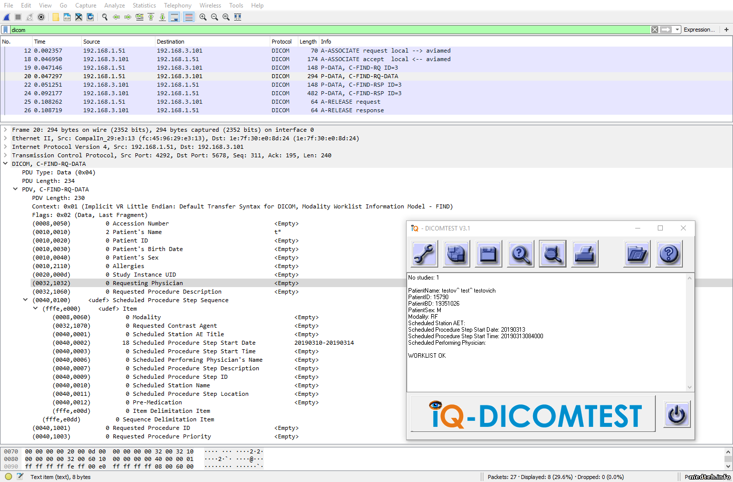

navesДата: Среда, 13.Мар.2019, 19:00 | Сообщение # 6
У вас сообщений: 1070
понятно, что ничего не понятно.
берите wireshark, и сравнивайте запрос из программы и с iQ_DICOMTest
а вы данные для ворклиста откуда берете?
не проще ли conquest запустить, а в нем ворклист сделать в виде sql view к нужной базе данных

AndreySm1996Дата: Четверг, 14.Мар.2019, 17:35 | Сообщение # 9
Программист
Попробовал отловить пакеты, с рентгена Wireshark-ом, но ничего не вышло. Он как будто их не ловит, хотя когда я IQ_DICOMTest посылаю на сервер запросы, WS прекрасно это видит, ну также как и на вашем скриншоте отображается последовательность пакетов. И теперь я вот думаю, верификацию то сервисы проходят, что Storage, что Worklist, но WS упорно не обнаруживает пакеты, которые должен слать рентген. Но на сервер исследования то приходят... shok
navesДата: Четверг, 14.Мар.2019, 18:19 | Сообщение # 10
ах-да, маленькие нюансы.
в вашем логе это чей адрес?
Accept connection Socket[addr=/192.168.101.1,port=49738,localport=11112]
раньше, клиентский софт электрона слал RPC-запросы на свой сервер, и уже там запускались COM-объекты, которые работали по DICOM.
используйте tcpdump на dicom-сервере с записью в pcap-файл, если у вас linux-сервер.
https://www.wireshark.org/docs/wsug_html_chunked/AppToolstcpdump.html
только укажите еще фильтр по порту, типа
tcpdump -i <interface> -w <some-file> port 11112
Сообщение отредактировал naves - Четверг, 14.Мар.2019, 18:21
AndreySm1996Дата: Пятница, 15.Мар.2019, 13:23 | Сообщение # 11
Программист
День добрый, tcpdump еще не успел посмотреть, жаль он не показывает содержимое пакета, как WireShark, но ничего.
С уверенностью могу сказать, что этот IP ни сервера (192.168.6.30), ни станции (192.168.101.100) станция кстати с двумя сетевыми картами (АРМ лаборанта в серверной конфигурации). Т.к. заканчивается на 1, смею предположить, что это IP роутера, но почему он отображается в логах не могу знать.
navesДата: Пятница, 15.Мар.2019, 14:36 | Сообщение # 12
tcpdump может показывать содержимое пакетов, но dicom бинарный протокол, и его нужно парсить.
есть консольная версия wireshark
https://www.wireshark.org/docs/man-pages/tshark.html
обе сетевухи подключены, какие на них адреса?
может просто wireshark не с того интерфейса пакеты смотрит.
AndreySm1996Дата: Понедельник, 18.Мар.2019, 10:40 | Сообщение # 13
Программист
Добрый день, я просто по IP сервера пытался ловить пакеты, разве это не верный вариант?
Что же касается сетевух, то одна сетевая АРМа лаборанта для внешней сети как я понимаю (192.168.101.100) и второй IP - внутренняя сеть с сервером, который шел с завода (192.168.4.3). но он даже и не пингуется.
navesДата: Понедельник, 18.Мар.2019, 12:33 | Сообщение # 14
Wireshark умеет одновременно захватывать пакеты только с одного интерфейса, и если выбрать неправильный интерфейс то ничего не будет.
Запустите Wireshark и посмотрите какая вообще сетевая активность начинается при нажатии кнопки получить список.
Давным давно меня тоже поставило в тупик, что с компа лаборанта вместо DICOM-пакетов пошли RPC-запросы в сторону сервера электрона. Потом уже только понял, что там накручено.
AndreySm1996Дата: Среда, 27.Мар.2019, 11:13 | Сообщение # 15
Так вот, если я добавляю на сервере в Application Entities list с IP станции лаборанта и портом 104 echo запрос с DCM4CHEE не проходит (см. скриншот), хотя наверное должен
не должен.
Логи из первого поста вы откуда взяли?
В любой непонятной ситуации используйте tcpdump (с)
Плясать надо от печки (с)
Запустите на dicom-сервере tcpdump, и убедитесь что запросы приходят именно с лаборантского компа. Мне кажется, у вас там рояль в кустах есть.
Сообщение отредактировал naves - Среда, 27.Мар.2019, 13:32

Логи рентгена выглядят следующим образом, он пишет как будто не нашел никаких новых заказов на исследование (см. скриншот)
