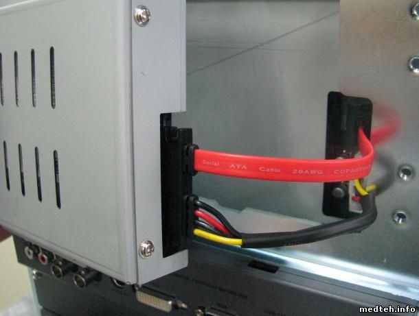

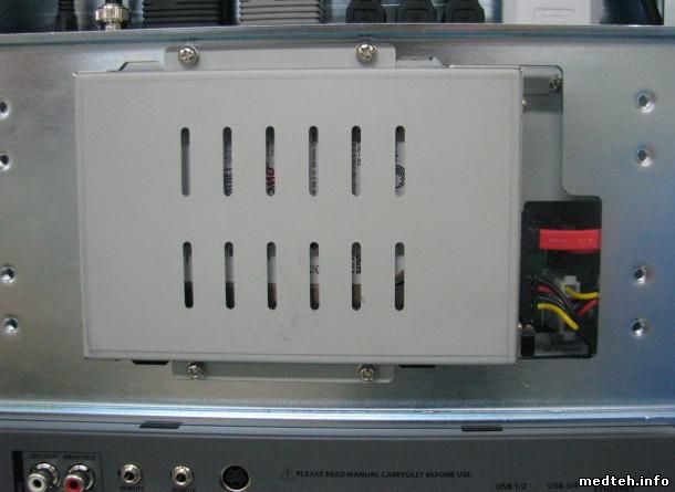

HDD Assy
• Disassembly procedure
1. Remove the air filter cover.
2. Loosen 4 screws.
3. Disconnect the SATA cable and SATA power cable from the backplane.
• Reassembly procedure
Change the new parts and reassemble them in reverse order of disassembly
Сообщение отредактировал valentin17 - Среда, 04.Май.2022, 13:31
