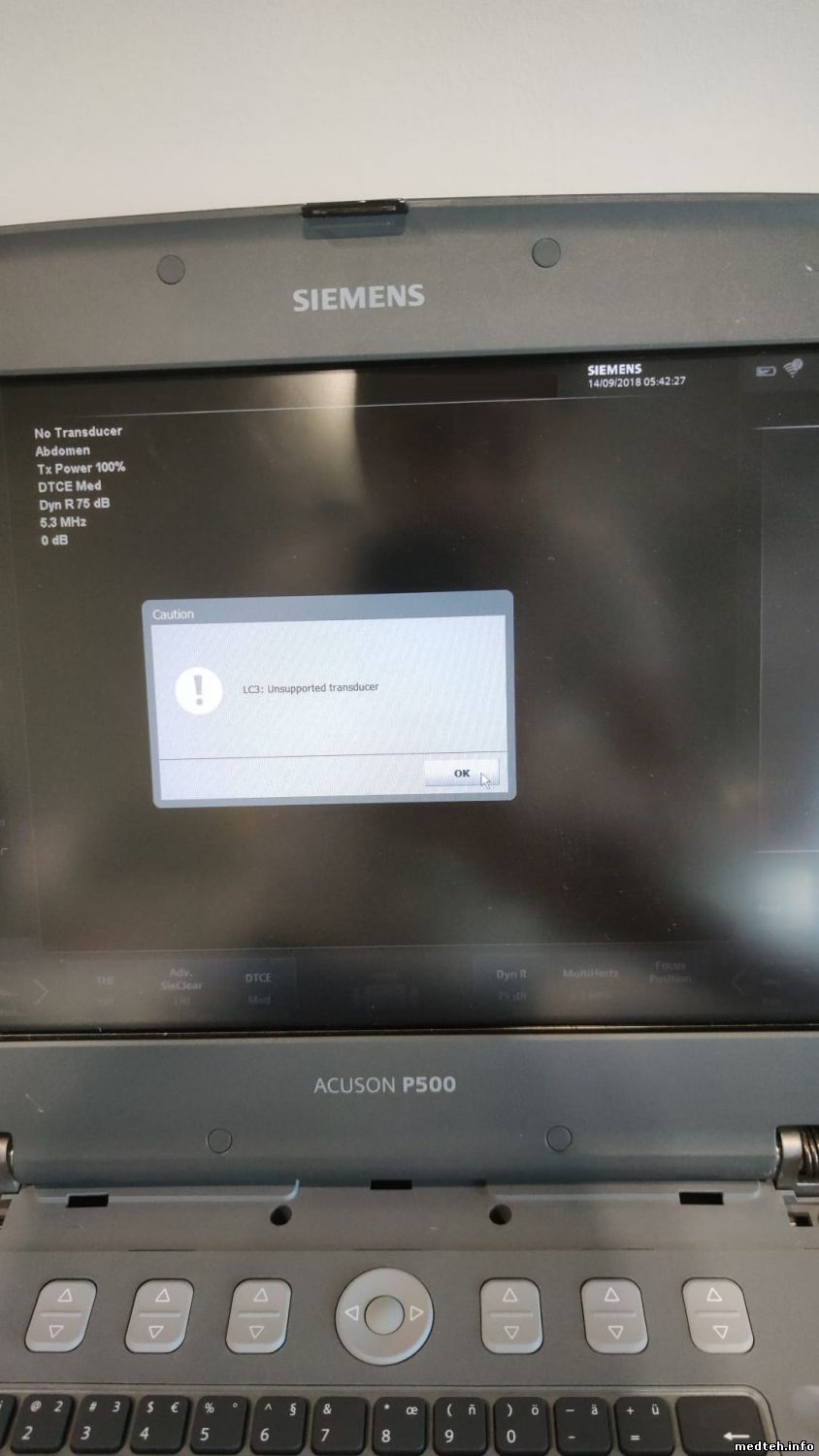

Acuson P500 от бренда "SIEMENS" - потребность в программном обеспечении.
Устройство работает, но не распознаёт датчики. Выдаёт предупреждение о несовместимости зонда. Датчики Ч5-2 и ВФ10-5.
В программное обеспечение устройства были внесены неправильные вмешательства.
Так что, мне нужно программное обеспечение VB10C 2.0.10 для этого устройства. Есть ли кто-нибудь, кто может помочь?

Hello.
The device works but does not recognize the probes. It gives an incompatible probe warning. Probes CH5-2 and VF10-5.
Wrong interventions have been made to the software of the device.
So I need VB10C 2.0.10 software for this device. Is there anyone who can help?

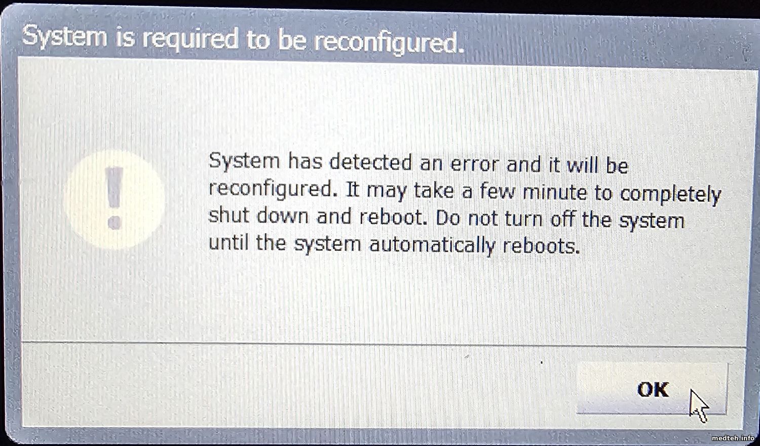

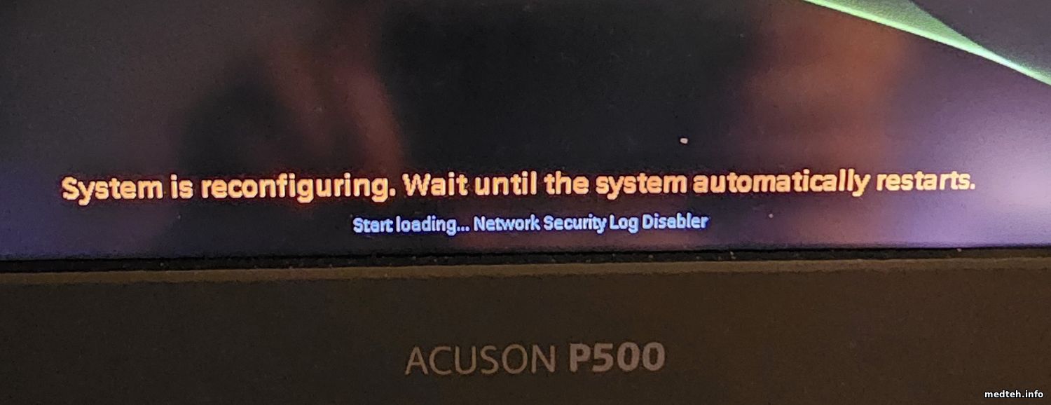

Hello.
Anyone have idea what to do* I've error on photo. Ultrasound boots up "resuming" Windows and it works, but pretty slow. When I restart or shutdown and power on, I interrupt resume with space to delete resume data and continue normal boot. Than I get this "System is reconfiguring. Wait..." 2 reboots and again start with resuming Windows.
I've tried to test SSD and memory, seems ok. I've reinstall software twice. Clean install didn't help. Factory reinstall didn't help too. Full system test from service menu say "PASSED" for everything. What can be wrong???
