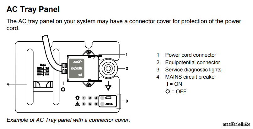

Hello. The device turns off after a while after it is turned on. and power lamps AC OK (permanent Green), 1st lamp (blinking orange) is blinking. I looked in the service manual, but I could not find a fault code for that lamp. Does anyone know this error?Thanks.

If you know the meaning of the blinking LED, can you tell me please? Led1

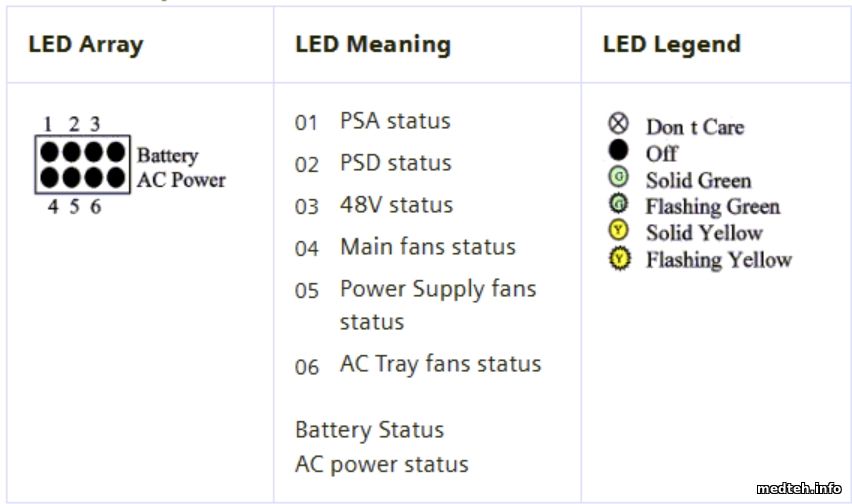

LED Status
First led blinking yellow meaning PSA error (overload, over temperature, over/under voltage). If overloaded - this can be caused by the EM, IO, TI, CP, RM or HDD.
