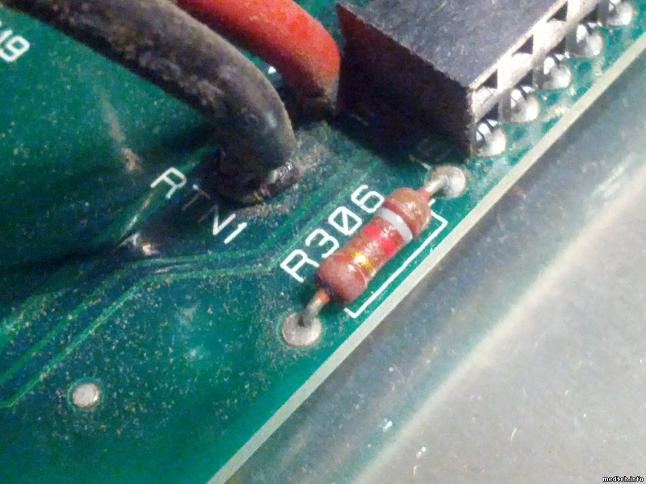

Заменил элементы, но опять сгорел R306.
Подскажите, пожалуйста, почему этот резистор сгорает ...

I replaced components but R306 burnt out again.
This time MOSFET 2N7002, Zener diode 27V and resistors are seems good.
Please tell me what shall I check, what is reason that resistor is burn out?
Сообщение отредактировал lhagva99 - Среда, 22.Июн.2022, 12:00
You're welcome.

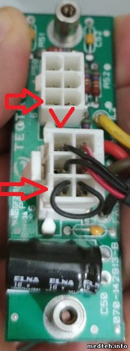

There are black and red wires coming from the bridge diode on the power supply body. If you insert these cables into the places on the card, the parts I marked and the R306 will be damaged. B+ red, B- black cable needs to be installed. The R306 resistor is connected to the drain leg of the Q300 mosfet. Are you sure the mosfet isn't faulty?

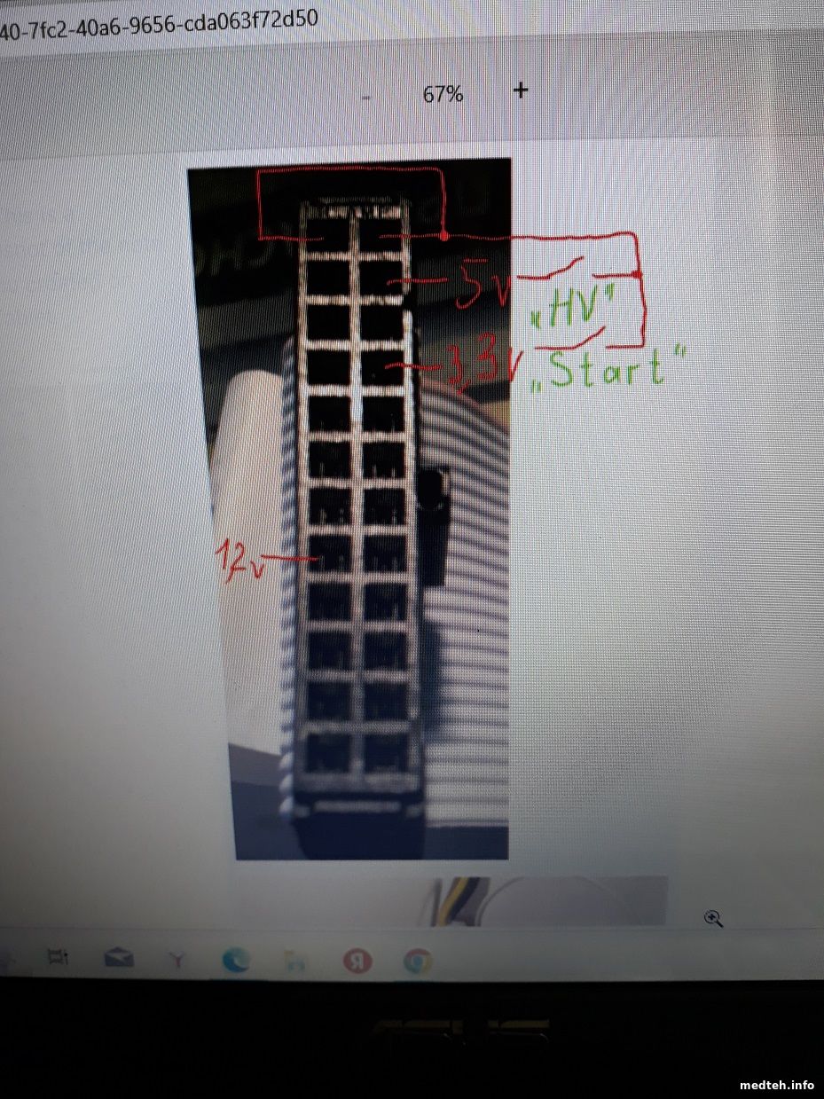

When you plug in the power supply, the stand-by part works. However, the inverter part does not work and the AC 150V voltage required for the PC power supply does not occur.
For this, you need to plug the fan sockets into the power supply. So this power supply won't work without plugging in the fan sockets. Or attach a piece of cable to the bottom pins as in the photo, that is, throw a bridge.
If everything is correct, the inverter part works and the voltage is around AC150V for the PC power supply.
Then connect the two slots in the 4th row from the top on the gray cable that goes into the Signal Processing card, which I showed in the last photo. If everything is correct, the power supply works and all the leds turn on. Good luck.
