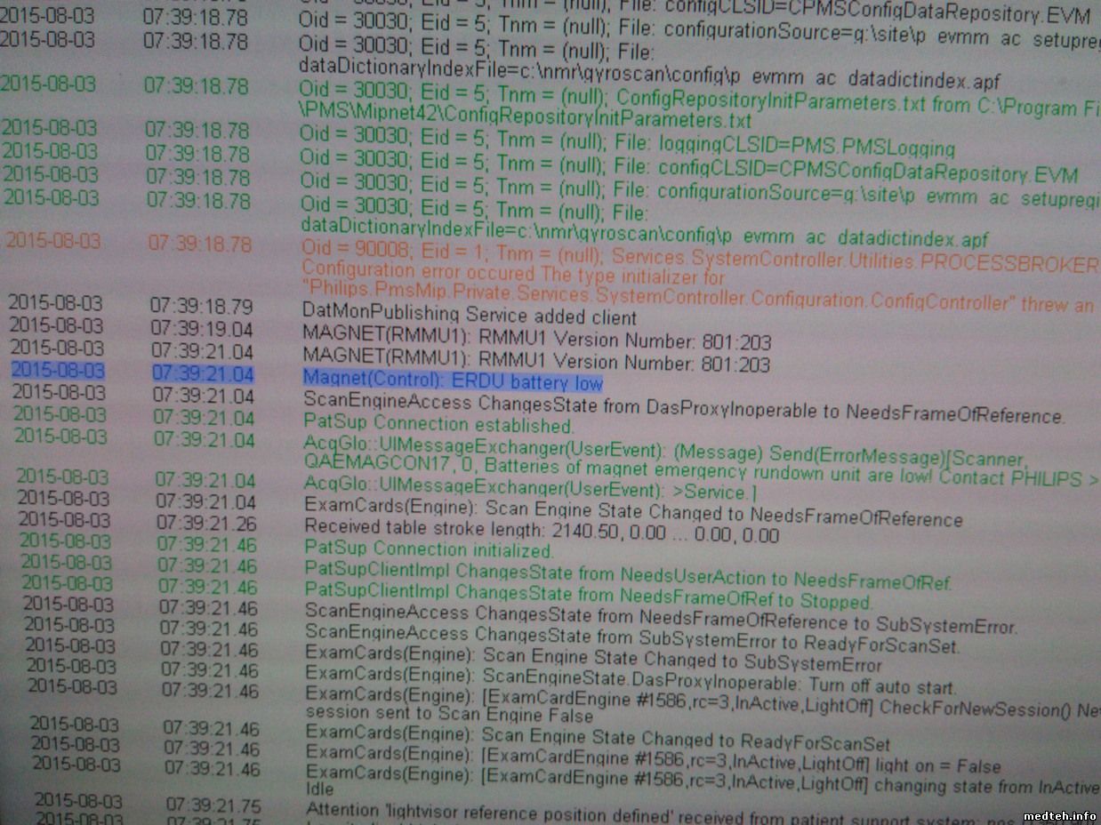

Здравствуйте, на МРТ PHILIPS ACHIEVA 1,5 T каждое утро вылетает ошибка - Batteries of magnet emergency rundown unit are low! Contact Philips Service.(логи имеются).Было предпринято - замена батареек на плате battery placement - результат ноль. Собственно вопрос на сколько критична эта ошибка и как её устранить?

На что поменяли, на точно такое же, или подобрали по параметрам?
vat21Дата: Четверг, 06.Авг.2015, 23:18 | Сообщение # 3
нет
Котлас
"Пальчиковые" - заказывали оригиналы. "Таблетку" - подобрал - правда не панасоник....

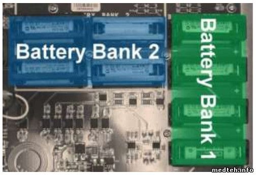

После замены "Battery Test" делали?
Аппарат на ночь выключаете?
Изучай процедуру:
Replacing ERDU circuit batteries in an MEU
1. Disconnect the MEU DC power at the MJ-X1 connector.
2. Disconnect the MEU’s 41-pin instrumentation cable at the MJ-X3 connector.
3. Remove the top cover from the MEU.
4. Remove the battery retaining clips from the first bank of 4 batteries.
Use a small non-magnetic screwdriver with a flat point to remove the battery retainer
clips
 Carefully put in the point of the screwdriver as shown.
 Carefully tilt the screwdriver as shown.
 Be careful. It is easy to cause damage to the battery retainer clips.
The batteries in the MEU are magnetic. They will be attracted to the magnet.
Hold the batteries tightly in your hand when you remove each battery.
5. Remove the four used batteries from battery bank 1.
6. Be careful not to cause damage to the battery retainer clips.
7. Keep the battery retainer clips. You will use them again.
8. Get four new batteries.
9. Install the four new batteries in battery bank 1. Make sure that you install the batteries in
the correct +/- direction.
10. Carefully push in each battery until you fully engage the battery in its battery bank.
11. Carefully push in the four battery retainer clips. Make sure that you fully engage the battery
retainer clips.
12. Connect the MEU DC power again at the MJ-X1 connector.
13. Do the Battery Test in the Service Application on the system computer.
Do not change battery bank 2 unless the test results are correct for battery bank 1. The
ERDU button will not operate unless a minimum of one battery bank operates.
14. Do steps 4 through 13 again for battery bank 2.
15. Put the MEU’s cover back on. Tighten all eight fasteners that hold the MEU’s cover in
position.
16. Connect the 41-pin instrumentation cable to the MEU.
17. Connect the power to the MEU.
18. Discard the removed batteries.

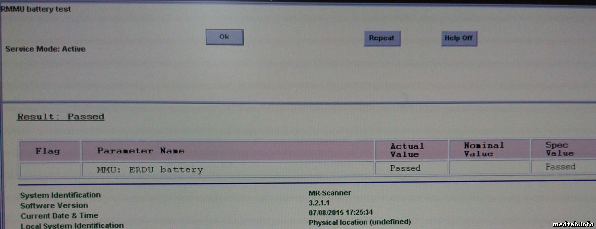

Странно. Ночью он сам должен был тест сделать. Ладно... Делайте так:
How to Do a Test with the Service Application
In the Service Application, select: System Adjustment  Test and Tuning Procedures 
Installation procedures  RMMU/MEU battery test. Obey the instructions on the screen.
How to Do a Test with Older Software Versions
 Select: MR Applications  Scan Applications  STT Applications.
 Select: Installation procedures.
 Select: RMMU battery test. Obey the instructions on the screen.
If the result is incorrect, replace the batteries.
Просто пока не проведен тест новых батарей, хост считывает старое значение
из MEU. Причем заметь: батареи меняются за два захода (банк1 и банк2) и для каждого делается тест. Филипс считает, что оставлять магнит совсем без батарей (даже полудохлых) нельзя (даже на время замены оных) - в случае форсмажора квенч-кнопки работать не будут. Безопасность превыше всего!!!

KVI, Спасибо за помощь...вопрос решен - не был сделан тест...Тему можно закрыть.
