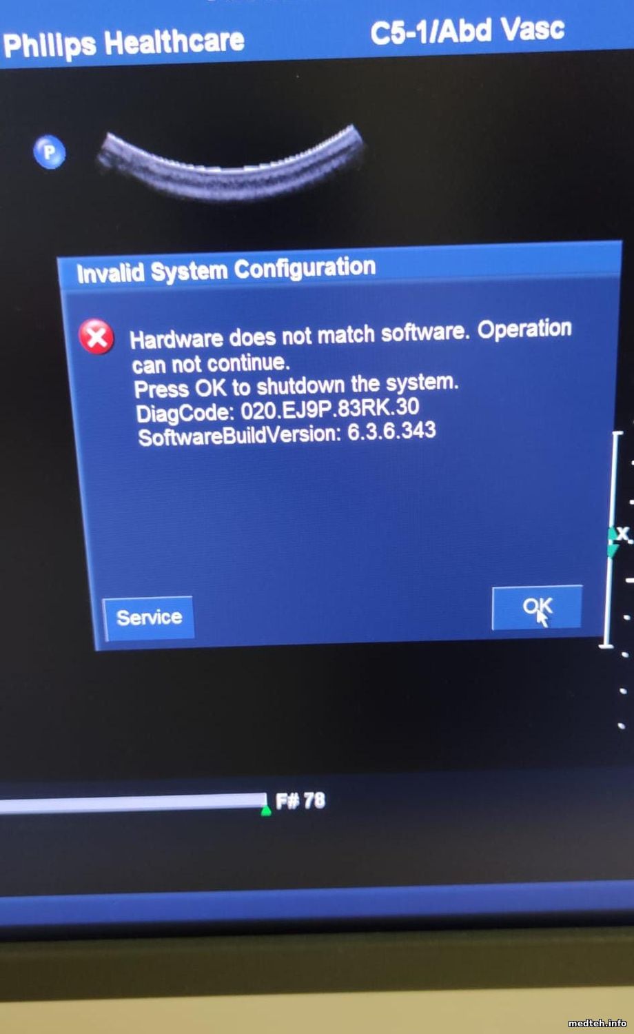

Hello friends.
I get a "Hardware does not match Software" warning on my IU22 device. You can look at the photo I added. I installed the software for another device, then I also uploaded the license file, but I could not find a solution.
I have encountered this problem before due to the monitor.
Does anyone have a solution suggestion?
Regards

Either use the error log browser or review the 'Expected versus Actual' list in System Config to identify which boards have the wrong configuration and replace as needed.
You should to check what is the difference between expected (in software config) and actual (hardware) devices. Compare VEN/DEV information. Then you can reconfigure software configuration manually (write actual hardware VEN/DEV in configuration file for required device). After that you should to reconfigure software for installing. Same procedure as for video cards.
