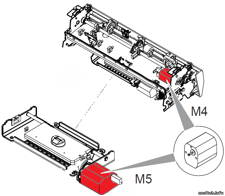

I have a problem with the Agfa 5302, the same problem with the OUTPUT module replaces the engine now it asks to CALIBRATE the module. HC306001 error
message displayed (NEW NOTICES: W306001 CDM INITIALIZATION FAILED: NO CALIBRATION).
I DO NOT HAVE THE SERVICE PASSWORD
Juciaro
Sokolov_SKYДата: Вторник, 21.Июл.2020, 07:50 | Сообщение # 547
У вас сообщений: 93
Цитата Juciaro ()
Hello
Hello!
One of the motors in the OUTPUT module is not working. Identify the defective motor, replace it
